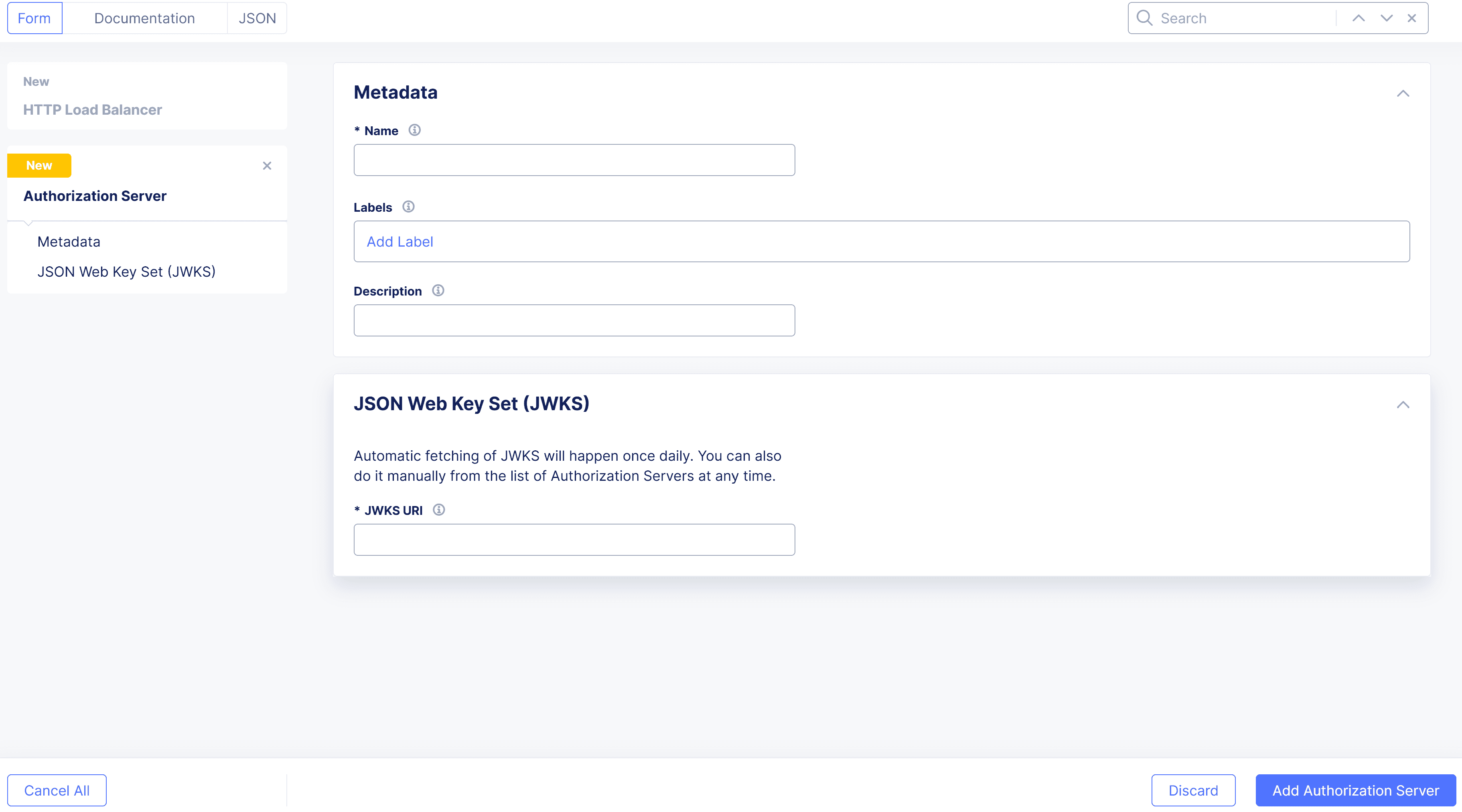

Authorization Servers: To use one or more Authorization Servers, select Authorization Servers.
In the Authorization Server Name field, select an existing Authorization Server, or add a new one by configuring the JWKS URI.
Select Add Item.
In the Name field, enter a name for the new load balancer.
Optionally, select a label and enter a description.
In the JWKS URI field, provide the URI of the Authorization Server.
Figure: Add an Authorization Server
The platform automatically fetches the JWKS from the configured JWKS URI.
Note: The JWKS refreshes every 24 hours. However, you can also fetch the JWKS manually from the list of Authorization Servers, if required.
