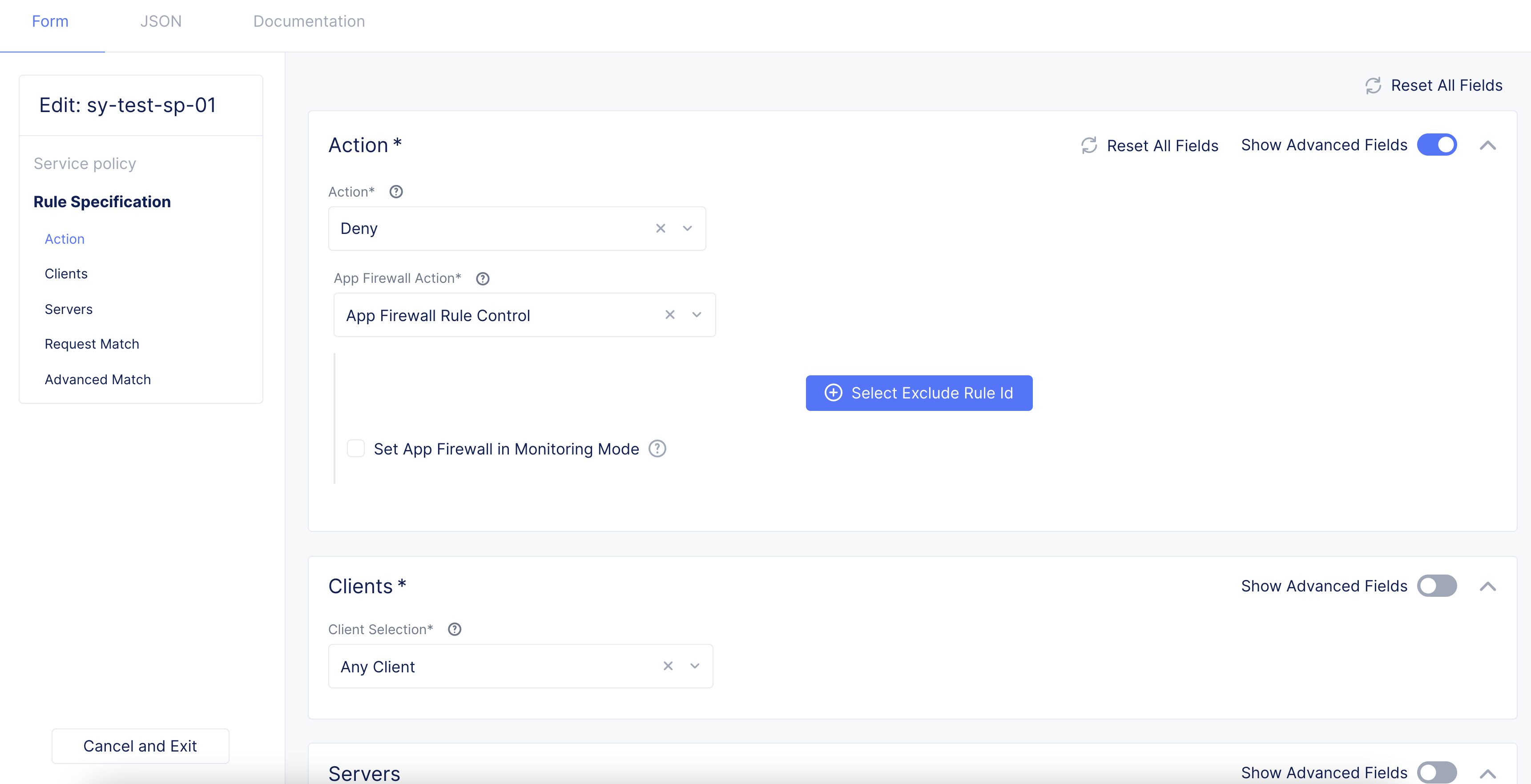

Edit. - From the
App Firewall Actiondrop-down menu, selectApp Firewall Rule Control. - Click
Select Exclude Rule Id.
Figure: App Firewall Rule Control

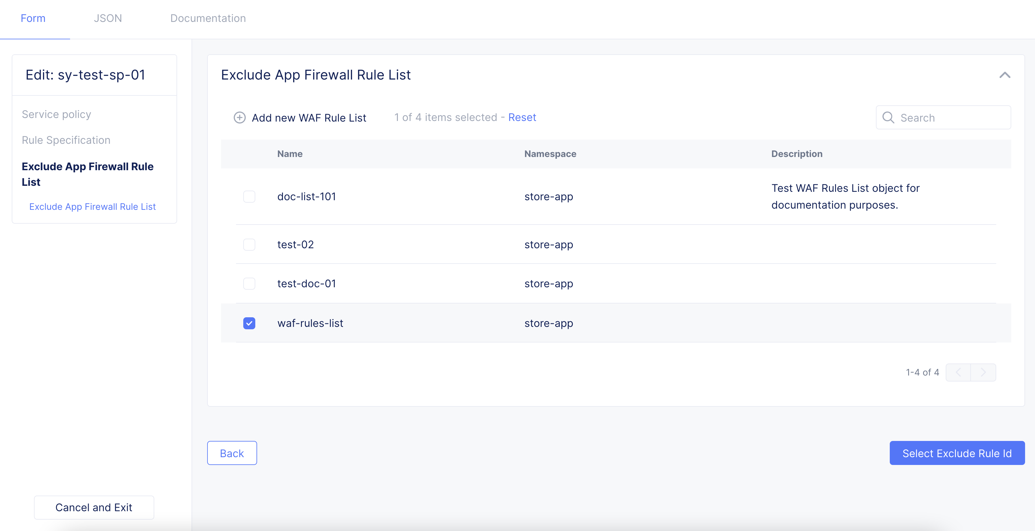

- Select the WAF Rules List, and then click
Figure: Rule List to Exclude

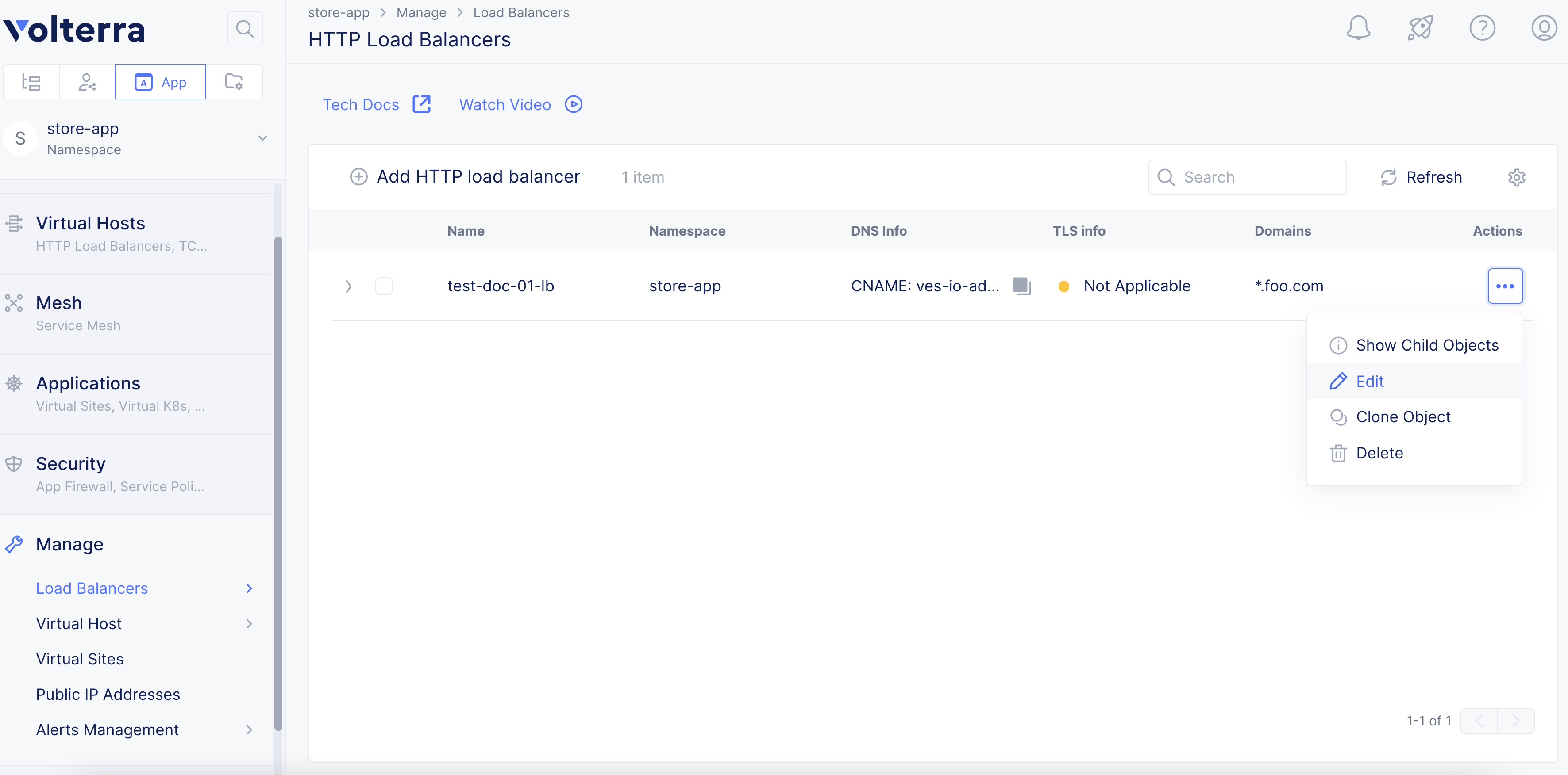

- In your namespace, click
Manage->Load Balancers->HTTP Load Balancers. - From the list, find your load balancer, and then click
.... - Click
Edit.
Figure: Select Load Balancer to Edit
