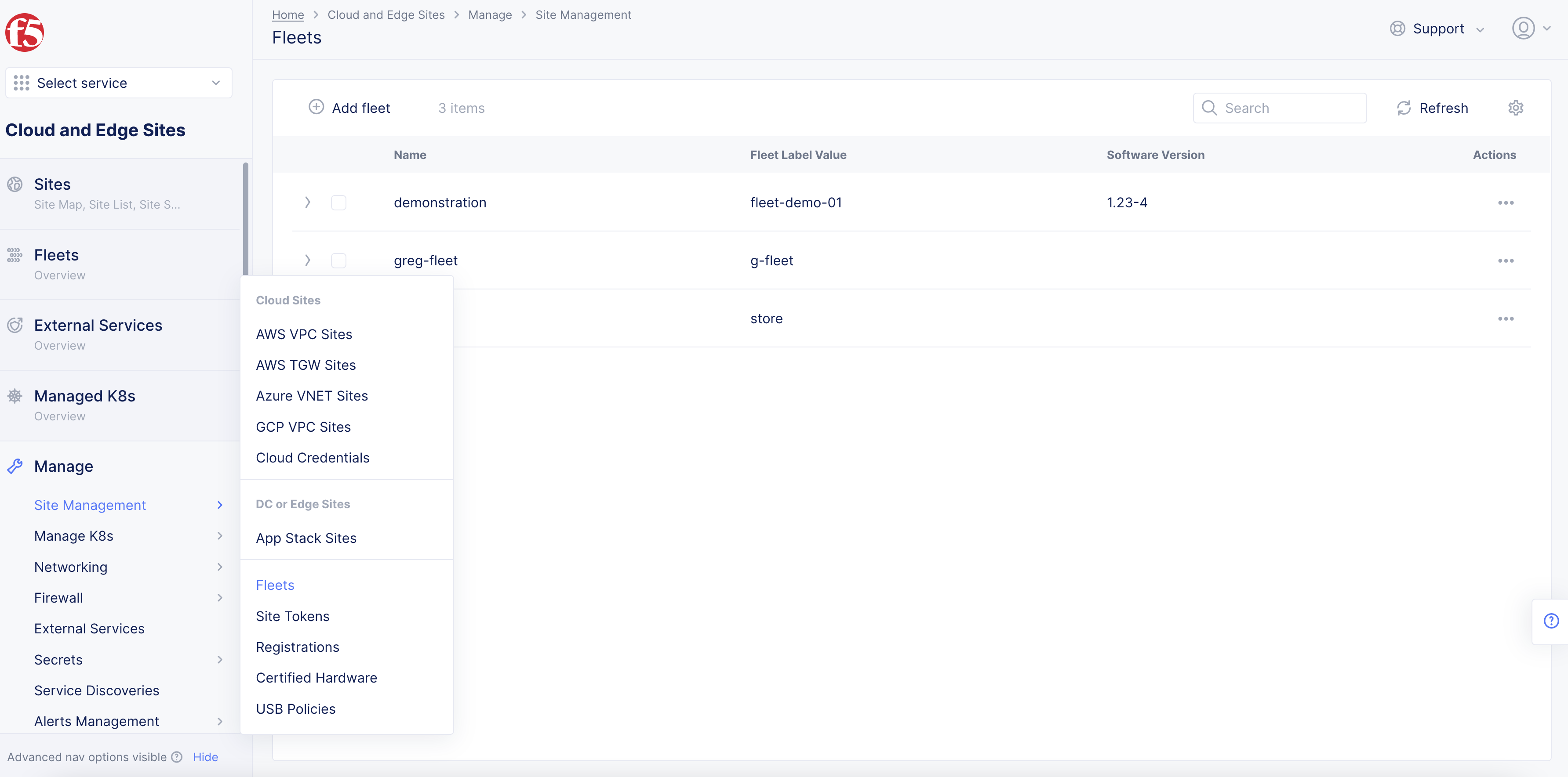

Step 1: Navigate to your fleet in Console.
- Log into Console, and then click
Cloud and Edge Sites
- Click
Manage
>Site Management
>Fleets

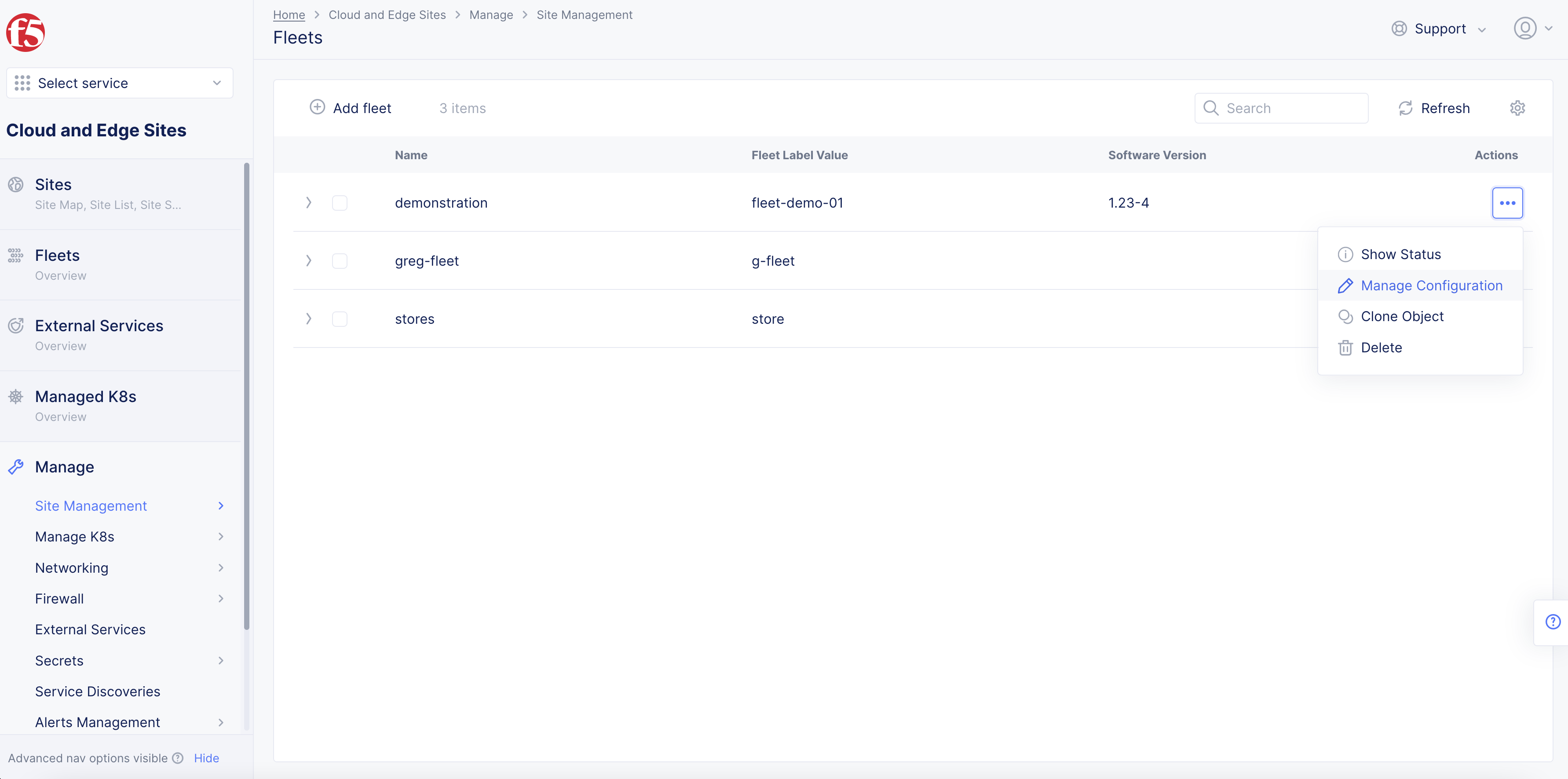

- Click
and then clickManage Configuration
on the fleet object to which your sites are associated with.
- In the form that appears, click
Edit Configuration
from the top right corner.

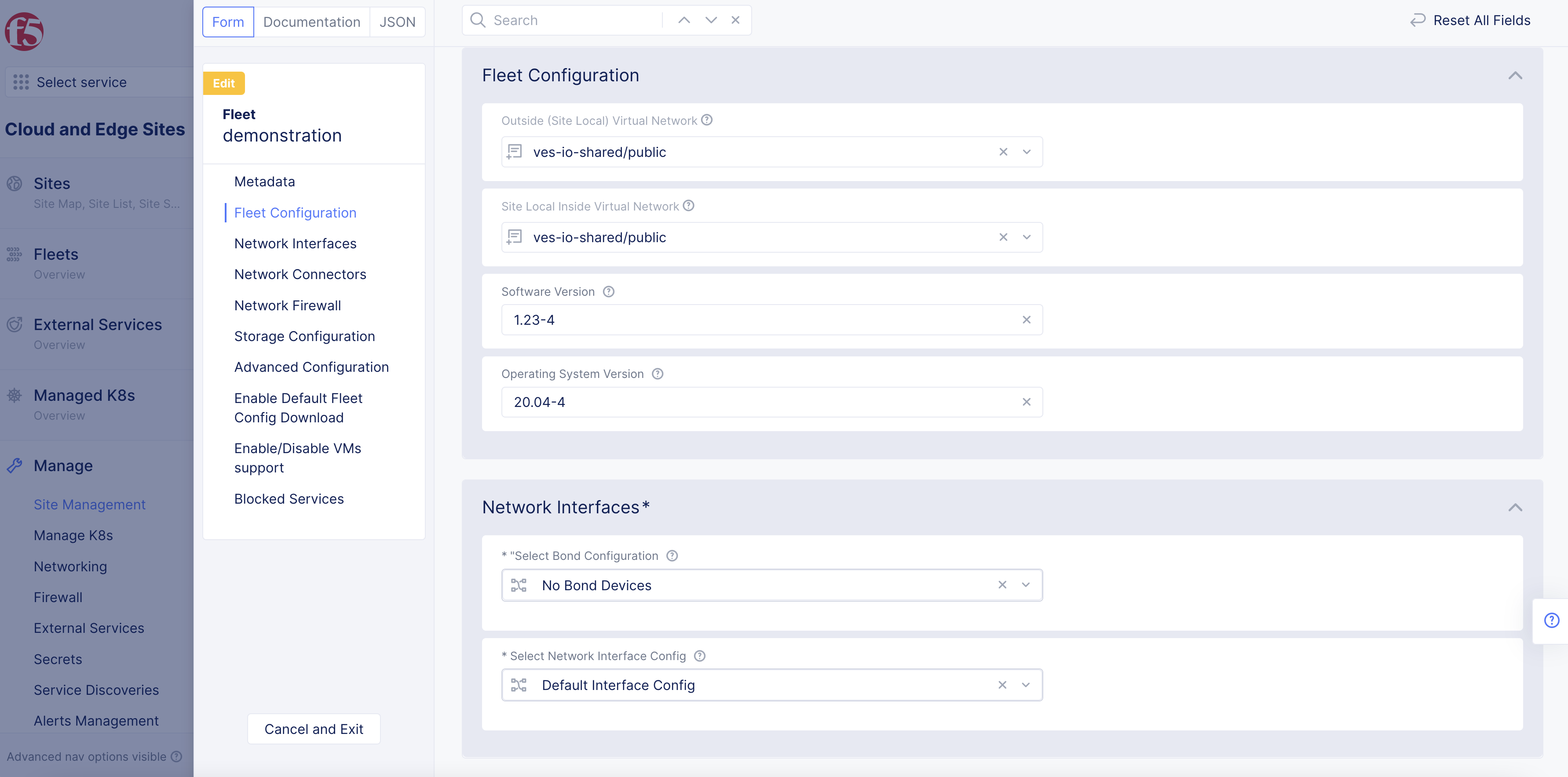

Step 2: Set the site software version and operating system version.
- In the
Fleet Configuration
section, enter the software version or operating system version to which you want the sites to be upgraded in theSoftware Version
andOperating System Version
fields, respectively.
Note: Navigate to
Sites
>Site List
. Click...
and then clickEdit
for your site and ensure that theFleet Version Overrides
option is set for theSite Software Version Override
field.
- Click
Save and Exit
to save the updated fleet configuration.
