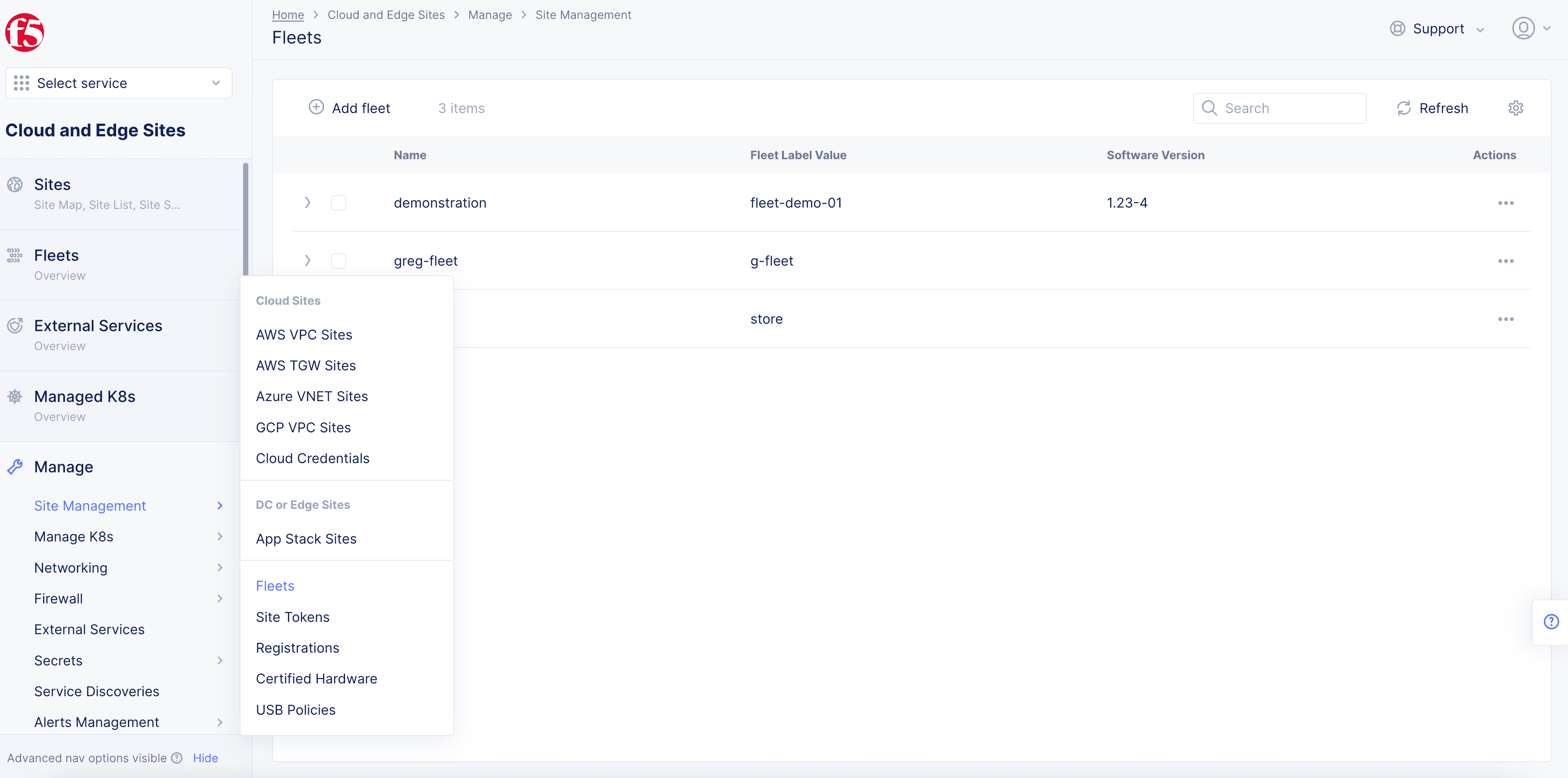

- Click
Manage
>Site Management
>Fleets
Figure: Navigate to Fleets

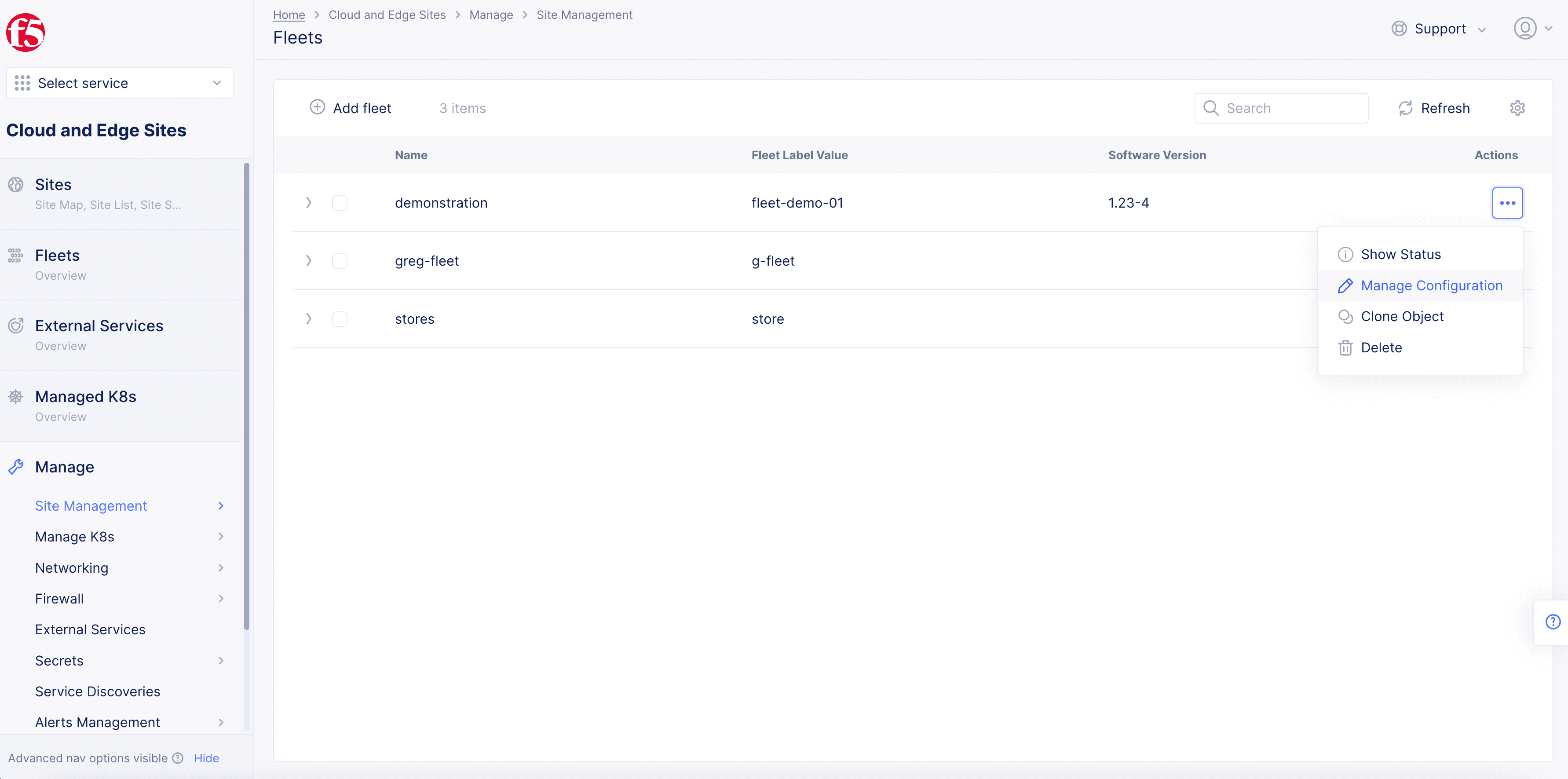

- Click
and then clickManage Configuration
on the fleet object to which your sites are associated with.
Figure: Edit Fleet
- In the form that appears, click
Edit Configuration
from the top right corner.
