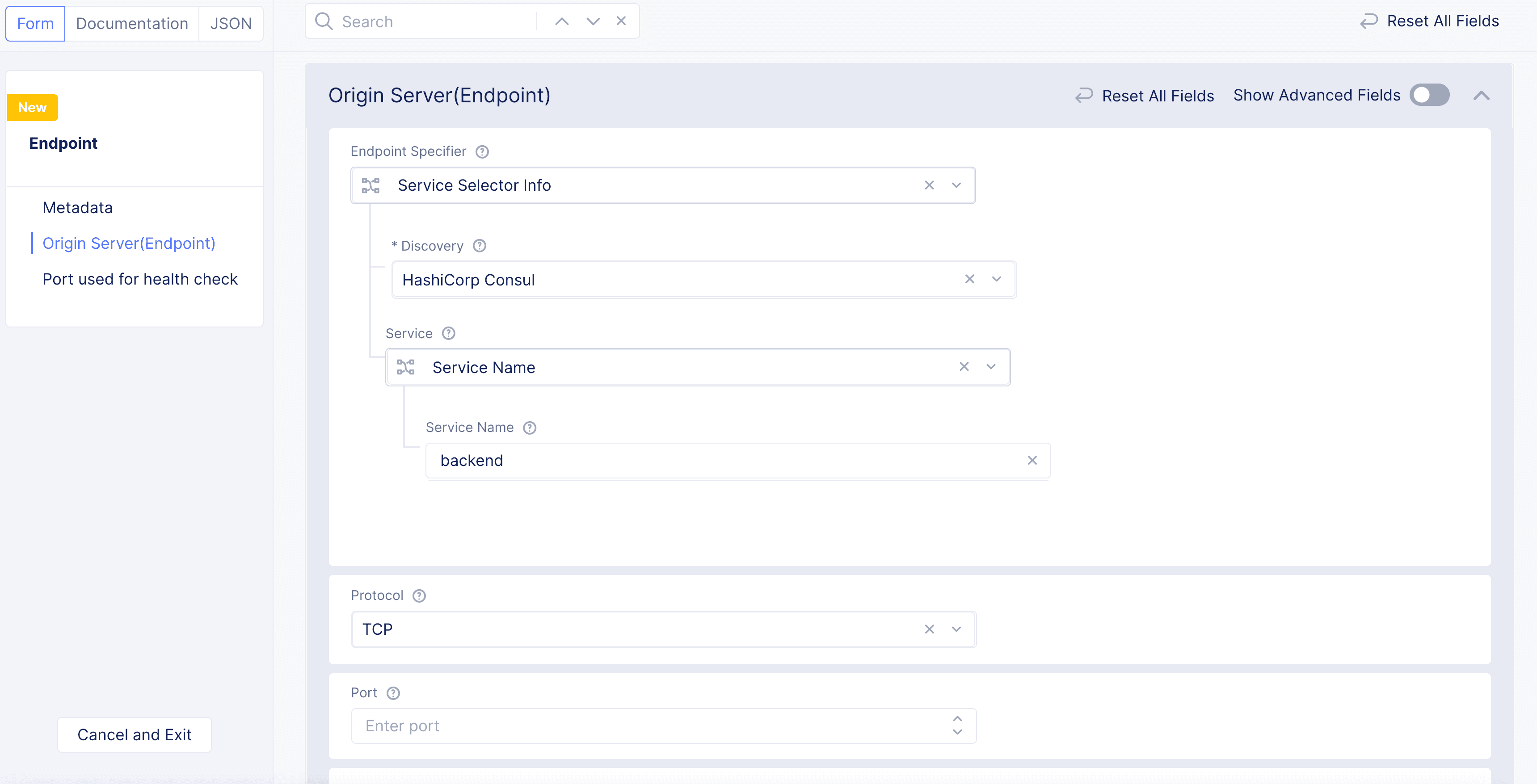

Step 4: Configure the endpoint address.
Configure where the endpoint should be discovered.
From the
Endpoint Specifier
menu, selectService Selector Info
. This option requires you to use a service name or label selector to reach the endpoint. -
From the
Discovery
menu, selectHashiCorp Consul
From the
Service
menu, selectService Name
Enter your service name in the
Service Name
field. Use the<servicename>
format.
Note: Obtain the service name from Step 3.

Step 6: Set port and protocol.
Enter a port number and a protocol value for the Port
and Protocol
fields, respectively.
Figure: Set Port and Protocol
Note: The port must be the service port of the Consul service and not the node port.
